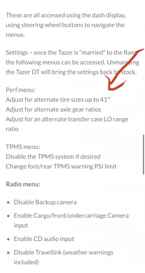

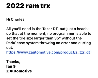

I was all excited that it could change gear and tire size up to 41”…. As 37’s are on my immediate list.
then an email from Ian at Z said that it’s a no go….
hmmm. Well I’ll be running the 37’s with out reprogramming via the tazer.
anyone know if the dealer will reprogram with the factory computers?
