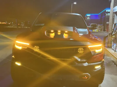

Just installed Tazer DT that I bought form @Boosted. Followed the instructions verbatim and everything works just as I wanted. Amber DRL, Power fold mirrors, Fogs staying on with High beams. If you pay attention, take a deep breath, and follow instructions, its very easy to use. Thanks to all the members that contributed.

Boosted, Tazer DT installed with all upgrades, all is good, but..for the life of me I cannot figure how I keep the Amber DRL lights on 100% of the time, all conditions , including the 3 hood scoop ones...
Is this possible? might you help fix, with steps, if it is?

Set the amber DRL’s in live features.
