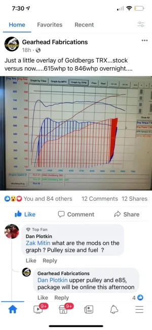

I’d keep an eye on RipaTuned, I know lots of shops are planning on getting TRX’s for R&D and that the 6.2 is very similar to those found in the Hellcat but Ripa Tuned is already offering packages for the TRX. He is currently selling 750,800,850, and 900hp packages for the TRX. He’s tuning his LE on E85 and said to expect 10second e.t.’s on stock 35’s in the very near future. Disclaimer: I do own a HellCat Challenger but have no affiliation with RipaTuned nor have I ever purchased parts from him. I do know he builds a lot of fast Mopars and I have been following him closely now that he is already tinkering with his TRX.
This is a local shop around me. They have already had some nice gains. Planning on getting some work done on mine when I’m back up that way. Talked to Mario and told him I wanted to use it for a everyday truck, not a race truck. Learned a while ago no need to make your daily driver a race car.
I have seen those Instagram posts, he never posted what the stage 1 WHP was. I do not have E85 available to me so stage 1 on a 93 tune would be my best option. Do you know what he was able to achieve on 93?
