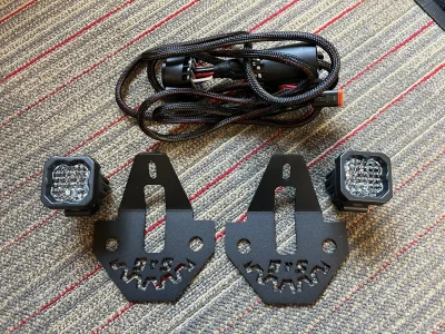

Any update on this? This is the only reason I haven't ordered yet.
Yes the strobe can be disabled by disconnecting the purple wire in the harness at the controller. Super simple. Sorry I never replied about that. I think @Eighty asked as well.

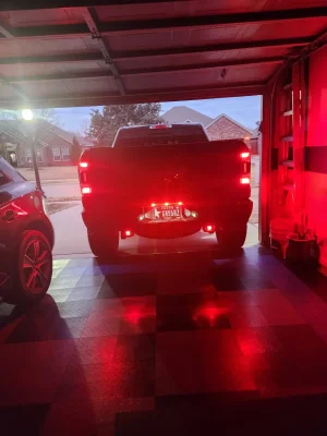

I really like my kit. I do think that I will rewire it so I can turn them on whenever I want vs just when in reverse.

Looks great. I made my own plug and play harness based on @Shifts_And_Grins instructions. I've got a diode wired in with one side going to reverse and one side going to my aux switch so I will have manual and reverse. Cant wait to get the light and brackets so that I can complete everything.
I love seeing everyone's different ways of wiring and using these. There are so many options and ways to run these. Thanks for the support from all of you.

@Shifts_And_Grins Sorry to bother, but you said we can turn off the strobe by cutting the purple wire. Are you referring to the one below from the video? Do you have a better pic or schematic? Sorry I am totally anal when it comes to this stuff prior to ordering.
I’ll pull a harness from inventory when I get back to the shop this afternoon and get you some photos.
