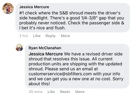

Driver side shroud was a bad mold. It was gapped approx 1/8-1/4 inch above the drivers side headlamp housing instead of sitting flush like the passenger side shroud. I trimmed the 4 tabs off the back of the factory cover. This allows the cover to sit flush against the air filter box. If you do not trim the tabs, the cover will bow in the center and you will not be able to align the holes for mounting clips. Trimming the tabs also provides the required clearance to close the hood.

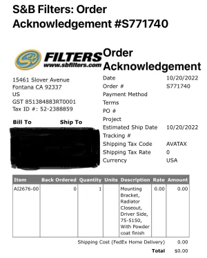

apparently they have an updated drivers side shroud they are willing to send per their post on FB
Thanks for the info. I reached out to S&B last night. Just received the attached email. Stand up company.
