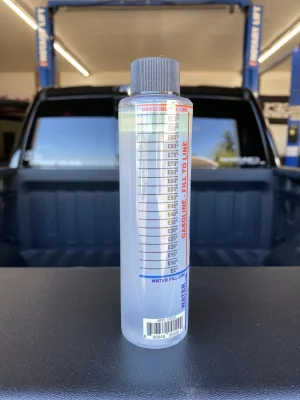

I get my e85 at a local station 10 minutes from my house. Funny thing is, there is only 2 stations in the entire state with e85 at the pumps.
Luckily it’s really good stuff that consistently tests right at 85%
