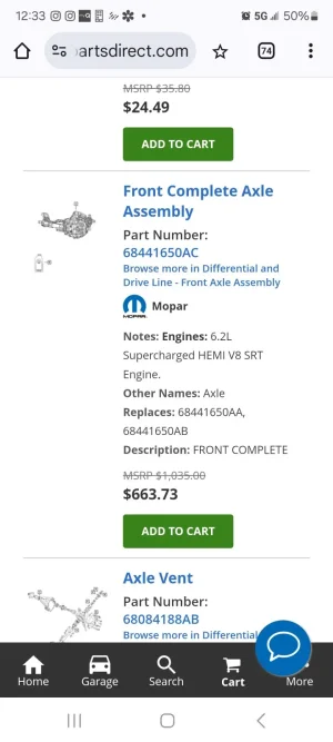

Thr front diff assembly is pretty reasonable for the trx. If the front axle assembly in the photo has all the internals installed, it will probably be easiest to just buy a new front RHO diff. The question will be availability for a while. Then we can just re-gear the rear axle.
Wow, that price seems WAY too low. Cheaper than a ring and pinion in most cases.

The actual catalog for the RHO specifically isn’t up on the dealer sites yet. Have to select a different trim level and do some workarounds to even get this far. Doesn’t really matter since the parts are currently unavailable anyway.
I thought the same thing. Gear setup alone would cost that much. I will happily install a new stub axle assembly but I don't mess with gears.
