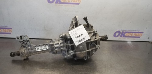

Okay, found the part number for the RHO rear axle and gears. I pulled these from one that was on the lot at the dealer that was doing repairs on my truck when I picked it up today.
Rear ring and pinion: 68658132AA
Rear full axle assembly: 68585347AB
Both appear to be available online. The rear gears are pretty cheap, only like $500. Combine that with the front assembly at $1,300 and it looks like you could maybe get away with a 3.92 conversion for a little over $2k.
It looks like the front diff is still hard to find though, so that might be a problem. I'm going to keep an eye open for a wrecked RHO, but if that takes too long I may order the ring&pinion and front pumpkin and give this a try.
It’s pretty dumb that the front diff is not available at this point. I really hope the reason behind that is they are putting them in the new TRX and need to stockpile them for production.

Anybody ever try this yet? Wish we could get something like a 4.88/4.55 but 3.92 or whatever the RHO's are is better than nothing i suppose
