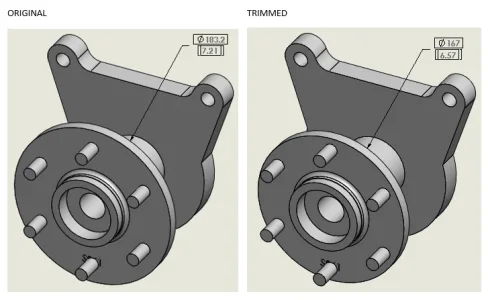

Our initial evaluation indicates that in order to develop a "meaningful" brake kit for a downsized wheels @17", the hub OD needs to be trimmed down as illustrated below:
The OE hub OD is unnecessarily oversized which can be trimmed down to the same as Toyota Tundra 00-06 which has the same hub feature as TRX (6x M14 lug bolts 5.5" pcd) allowing to fit a well designed and effective brake kit.
1. Loosening the back 3 bolts​
2. Remove the hub bearing​
3. Cut the hub​
4. Replace the hub and tighten the bolts​

This modification is necessary due to the geometry constraint for building a healthy and worthy brake kit.
For those wanting 17" brake kit, feel free to express how comfortable you are in this modification, we can help to do step #3 (machining) if required.

I'd be open to the modification assuming stress tests are done for strength.
