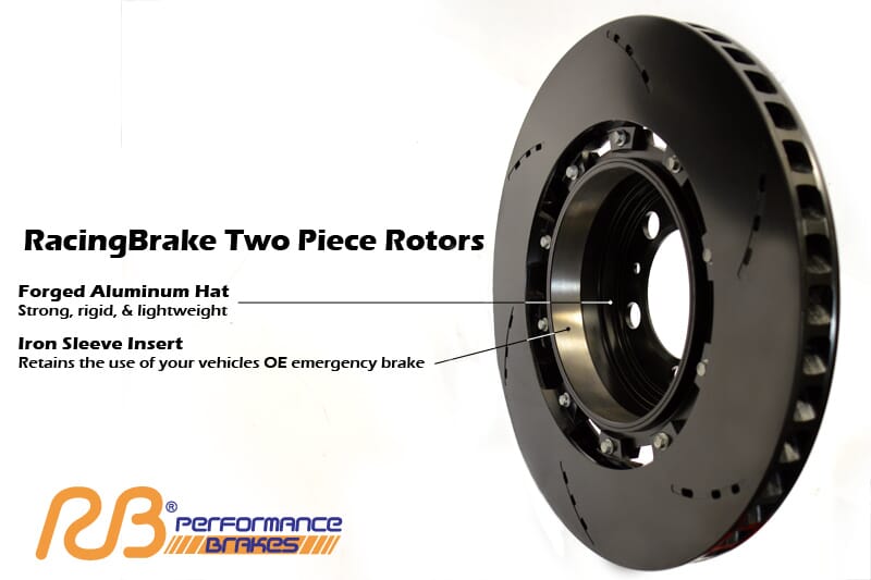

The ePB becomes popular for the rear around 2016 (replacing the drum brake) due to the weight and "cost" saving, but most people usually got confused between "parking" and "emergency". Conventional drum brake has the dual function both in parking and emergency stopping while the ePB servers only for parking and can never for emergency stopping, I test drove it one time by activating the "P" button and I was almost thrown out of the window.
Here is a thread I posted on Trackhawk forum to caution Trackhawk owners be aware of what they are getting on other vender's rear two piece:
This is how RB rear rotor hats are made - Light weight aluminum shell with "iron sleeve" insert for the brake shoes vs. other brand machined from aluminum stock just to fit the brake shoe, and the worst part is this vender doesn't even disclose to the consumers, like other known brands, to advise consumers "to delete" the rear brake drum.
Have you noticed the carbon ceramic rotors supplied by Brembo for cars with drum brakes (Corvette ZR1, Camero Z28, Porsche 911) all use stainless steel hat (heavy too) but functional because Brembo is a legitimate brake company.

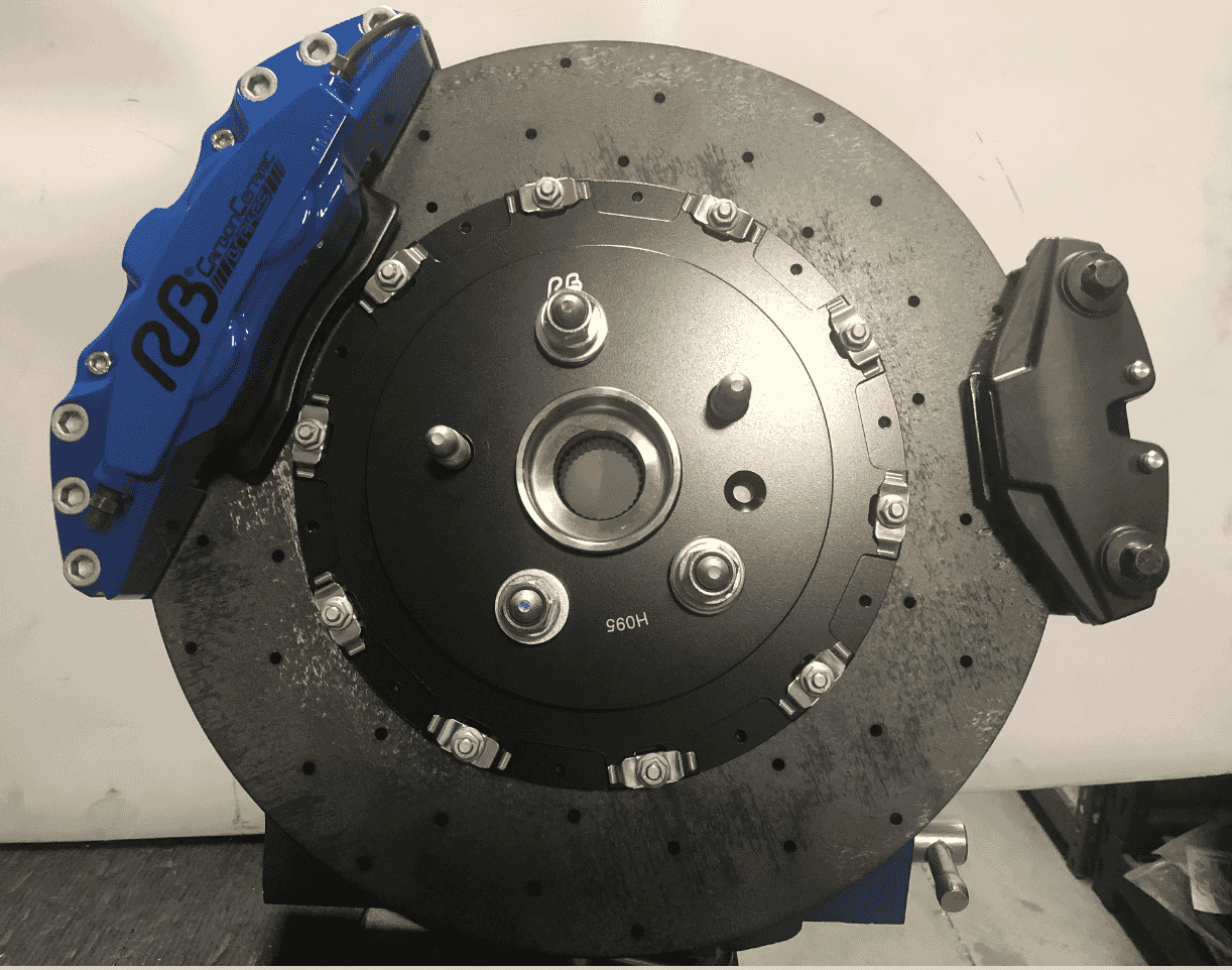

I do agree that rear ePB should stay intact w/o being altered. It's what we call "integrated" rear brake; the hydraulic caliper serves for the stopping while the ePB serves parking.
"Integrated" means it should not be separated or it's integrity may be impaired.
Another alternative for the rear is a "separated" parking brake like you will see in some of the high end cars:
  • Mustang GT500
  • Corvette C8
  • Ferrari 458
  • McLaren 570/720
  • Tesla S
A rear caliper adaptor is used to space the caliper out for a bigger rotors w/o messing around the parking brake caliper.
Corvette C8 rear RB BBK (CCB upgrade) - OE parking brake caliper
Tesla S Rear RB BBK (CCB Upgrade) - OE parking brake caliper

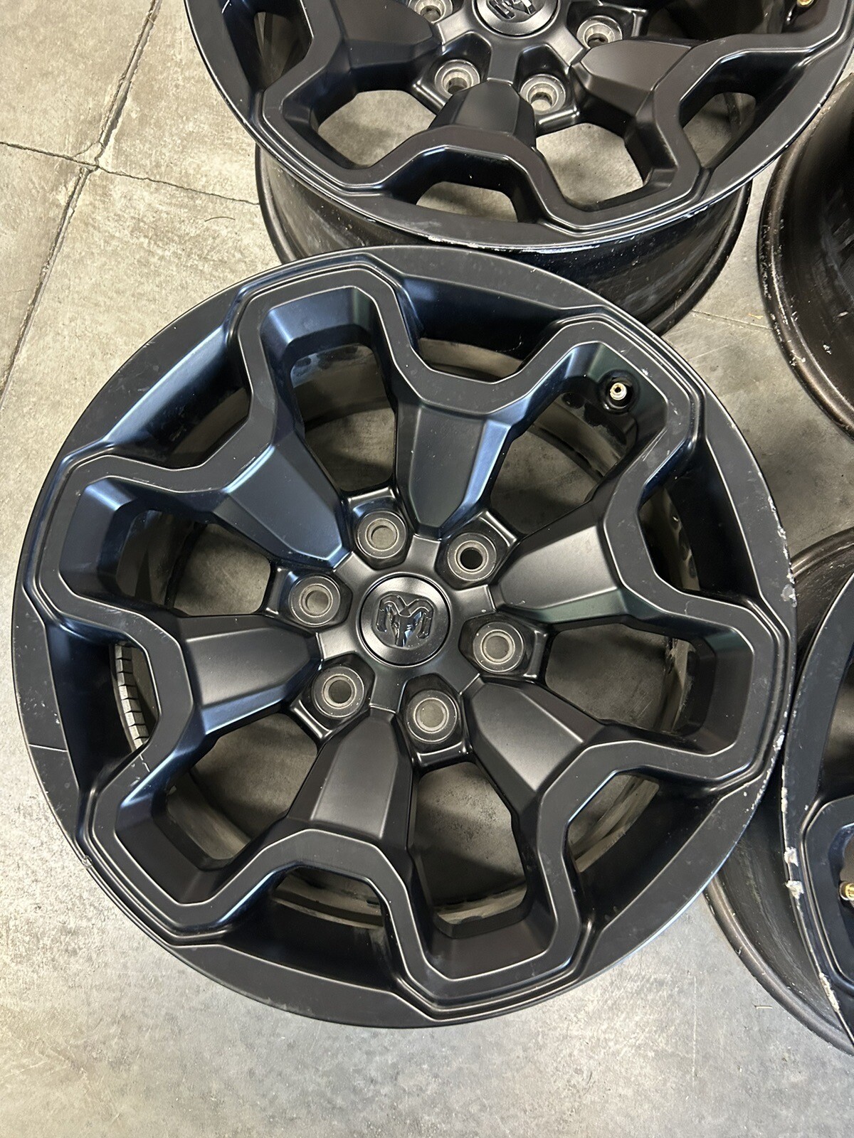

OE 18" Wheel (30.5 lbs)
Where are you located? I may be able to send you a 17” wheel. It’s a METHOD 701. Very popular model.
That's truly appreciated.
1556 Kimberly Ave., Fullerton CA 92831
We can send you a call tag, pls pm me your email address.
