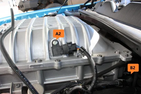

I have no idea how we would get to the sensor on the back of the motor in the TRX since ours sit farther back than a Charger/Challenger, specifically B2 in the picture. The other three sensors seem easy enough but that one would almost need a contortionist with extendable arms.

Nah. I spoke with them and with a shop who has done some. You have to do it by feel and you have to pull off the air box. Once all the plastic crap is off and the cross member is removed you lay your body across the top of the blower, think Superman flying, reach your right arm down and do it by feel. It’s not that bad.

Literally how I was going to try and describe it but couldn't quite get it there. Well said! That is what I figured just the flying blind thing is tricky but otherwise a straight forward install. I know you mentioned it not being 1+1 with the incognito but have you spoke with anyone running both yet? Between those and the ProFlex E85 conversion, A) I wonder if they all would play nice and B) if they it would be like 1+.5+1?
