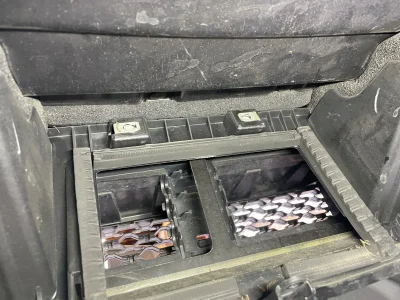

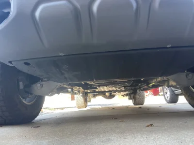

Step 1: remove skids like for an oil change

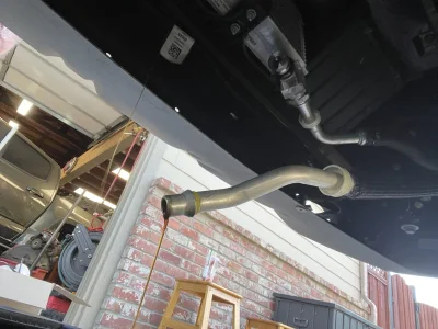

Drain oil. Keep oil pan under the oil cooler

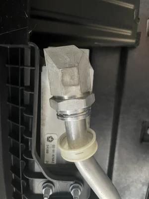

Pull back the plastic retaining ring covers.

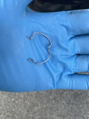

Use a pic or a non marring pic to remove the retaining clips. Don’t break or loose. They are the common part, can be found on Amazon etc, but better to remove and reuse.
Pull oil hard lines out from the oil cooler. They will drain more oil. About 1.5 qts

Oil draining and the retaining clips

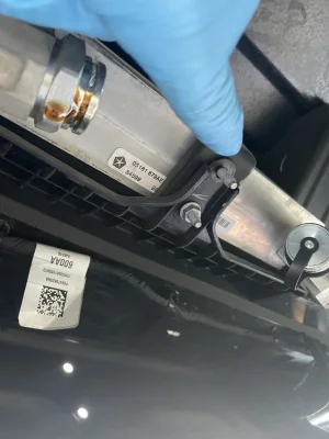

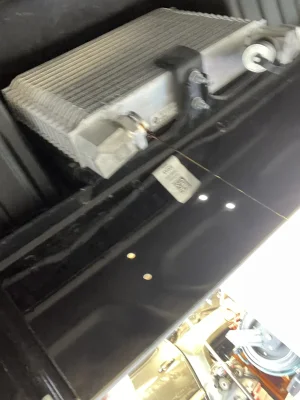

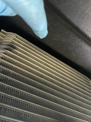

Remove the two 10mm at the bottoms and the two 13 mm top bolts (pic for reference once cooler is removed)
Slide lower bracket off. You will need to flex the plastic a little. Don’t worry, it’s got tons of flexibility.
Remove cooler and finish draining

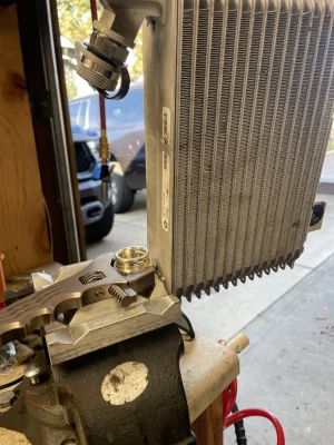

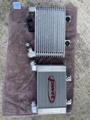

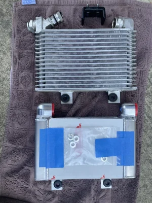

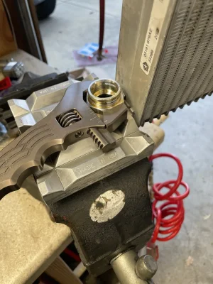

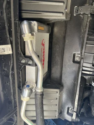

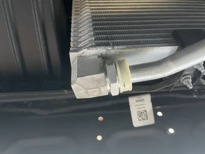

Swap the orb fittings from oem cooler to pwr cooler. Don’t damage the o-rings.
I used aluminum clamp in my vice to hold the cooler and a -a wrench. I think it’s -14
Don’t clamp too hard. It’s aluminum.

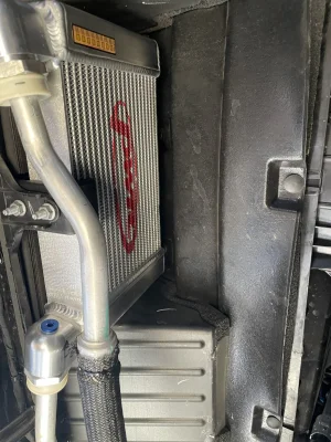

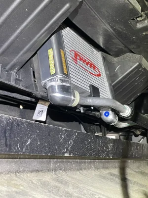

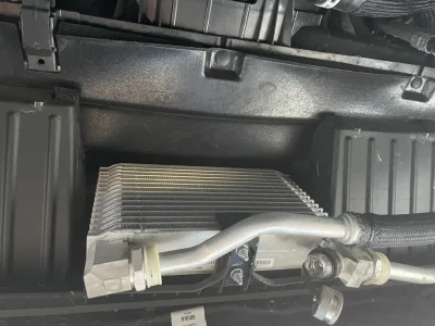

Install is reverse.
Make sure you the retaining clips are seated correctly. There are 3 points on the clips. Then cover clips with plastic covers.

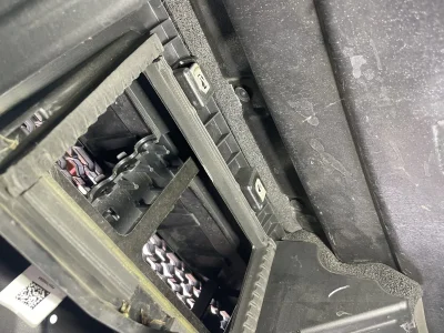

Hardest part is reinstalling the 13mm bolts at the top if you have fat hands

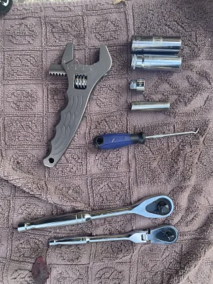

Tools I used.
