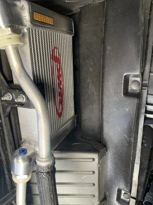

The good news is the guys at PWR are waaaaaay more forgiven and flexible than I am.
I passed the word on about everyone’s request for fujimoto etc valve installation.
I gave them the thread size for the factory plug (they already had it, but I also had the package sitting in a box)
He said it shouldn’t be a problem to make the coolers with oem thread spec so those who want a valve can use it.
I compared the oem to the pwr cooler and they are just about identical in size. The pwr end tanks are bigger, and the heat exchanger on the pwr is slightly bigger because of the type of cooler they use. Where the oem has a transition area where there is no cooler, the pwr heat exchanger goes all the way to the tank.
I spoke on the phone with Tyler and he said the core they used is a lot more efficient than the factory one. So that should be good.
He said come summer if the oem fitment one can’t keep up with those of us hammering in the desert or really really abusing things, building a stepped cooler or doing a fan shouldn’t be a problem.
I’m pretty excited. I have a good drive tomorrow that will give me a good idea about sustained heat generation. Then a trip in a week and a half or so to hammer off-road. It’s still in the 50’s and 60’s so climate is friendly, but especially on tomorrows sustained rpm event, where I’m normally 240-250, I will be able to see if this new cooler has a decent effect.

Looking forward to seeing the results!

Did a drive to the kids Kung Fu this late morning. I did the same drive 2 weeks ago in 57° weather and got the following
Oem engine oil cooler
Sample ECT. EOT. Ambient
1). 199°. 197°. 57°
2) 206°. 217°. 57°
PWR oil cooler
1) 197°. 176°. 63°
Now granted there are things like air density, humidity, driving style (although all 3 were driving in regular town traffic below 48 mph on the same roads going to the same place) but that was a huge drop. I’m driving past the same spot in a couple hours and then off for a freeway drive
Little bit harder drive yesterday.
Oil temps topped out about 207!
Iirc about 15° less than it usually is on that drive.
So I’m definitely seeing a drop in temps.
I just need to see how it does on a really really hard run. Get it into the 230’s
