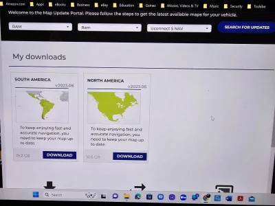

The latest map update is 2023.06. Has anyone downloaded this update? Any notable differences?

The update took 28 minutes up upload.

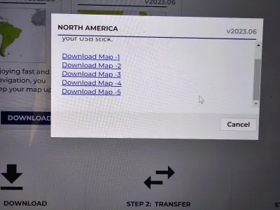

I'm just trying to figure out how people are seeing 9 files, when it's only coming up with 5 files on my computer ⁉️

Same Problem happened to me. You guys have to scroll down farther.
EDIT: this 1 does only have 5 files!

downloaded the latest map update from the site. v2023.9. Appears there are 8 files. they came in a zip file. When I extracted they went into a folder with the same name as the zip file. Is it safe to assume that I do not want them in that folder on the thumb drive?
