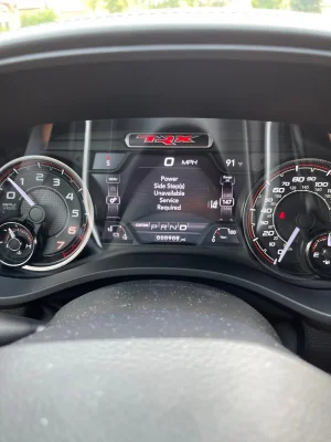

Has anybody had the mopar step only go in and out half way? then when driving at stop lights goes in and out? Turned of the truck and it went back to normal. happens randomly. Will tell the dealer as i have only had it for 1 day checking the real knowledgeable crew
Yes, mine does the same thing and I get the following notification on my dash (see pic)

Just shot you a message. Did you ever resolve the issue? My dealership cannot figure it out
You probably have a bad control module or motor.

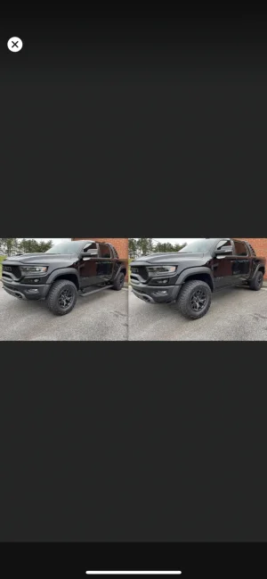

If they are able to stay down from the pics I’ve seen it looks like it would offer protection to the rear door rockers but not much on the driver door rockers. I still haven’t gotten any confirmation if they can stay deployed while driving though.
So, with the factory power running boards I had on my '19, I was able to keep them deployed like in that picture when I was in park. It was great when I was trying to protect against door dings. The problem is that when I had them deployed and putting the truck in gear, after a certain mph got reached (like 5 or 6 mphs) they would then retract to the stored position. I know guys with alphaobd have been trying to find a way too keep them retracted through configurable options but I have also seen no confirmation if someone figured it out. An option may be to cross wires or something to trick the system into thinking extended boards are in the stored position, but that is beyond my expertise :)
