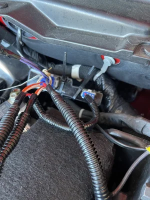

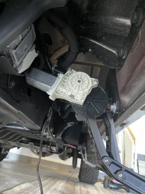

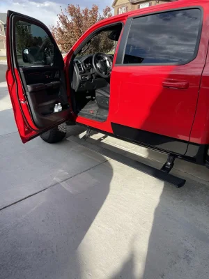

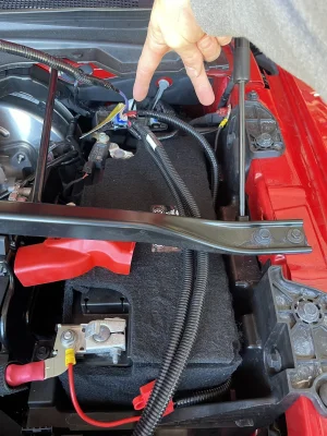

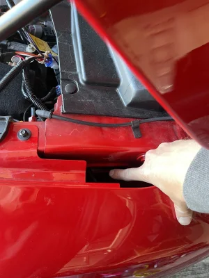

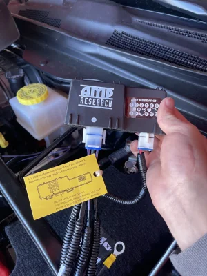

I purchased AMP running boards. They are nice. They would be easy to install if the directions were any good. Hey, I’m not a mechanic, but I do know how to read. I would say, maybe the worst set of directions I’ve ever seen with the exception of IKEA.
I bought them from JustBoltOn.
If you want some photos, here they are.
The very first step says that in TRX models you don’t have to do it. (Take a bracket off) uh, you actually do.
AMP should supply photos for their directions. They should also ask any of their customers for installation feedback. Beside the horrible installation experience, they do perform nicely.
