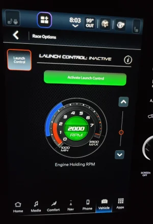

Mine updated to 35.26 this morning. My performance pages took an hour to come back and now I am missing the shift light button and race cooldown button in the race options. My drive modes revert back to the auto button after I select a drive mode on the center screen but seem to stay in the drive mode I select. Before this update, everything was working correctly even though I had the RHO graphic. Why in the hell is it so hard for Ram to get these updates right? They must have hired some Ford software engineers!
