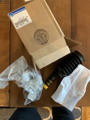

The kit does exist (at least when I ordered it it did), I ordered it and it shipped from a dealer. I ordered directly from Mopar and it shipped from Lithia CDJR in Pocatello. Mine is available since I won’t be using it if anyone wants it. Kit includes the grease, clamps, bolts, a new boot… and instructions.
I am refering to the 68597291AA Kit for $1.69. It automatically supersedes in the order system. There is not an option to buy that part from the dealer. If you got some a dealer to sell it to you for that price then they took nearly a $100.00 hit on it. That is something I could not do and 99.99999% dealers will not do.

I just ordered it online on the mopar site. It shipped from the Pocatello dealer. I had no clue which dealer it was going to ship from.
I followed your lead RobR651 and ordered from Mopar site. With shipping total cost is a little over $5. Says it will ship from a dealership in my state but not the closest dealership to me. I am guessing the closest with it in stock. I hope they send it as I would prefer to do this myself
