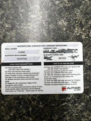

My installer did not give me a card with an emergency code, is there a different way to find out what it is? Installed in Houston.
He should have gave it to you. Contact him and have him atleast scratch the emergency code and text it to you. If you forget your pin you will need it to make another. Making a new pin is easy though. Turn ignition on by pressing twice, put your pin in, hold gas to floor and put in pin again, it should start flashing hazards every 2-3 seconds, release gas. Put your new pin in, it should flash 3 times, put same pin again and it will flash 2 times if its the same pin, 4 if it isn’t or if it didn’t work right. Turn it off and it will be changed.
You will need the emergency code because without that card you would have to take it to the installer again to have him gain access to the IGLA and put it into learn mode in order to make a new pin.
Card looks like this (one of my cards from one of my vehicles)
