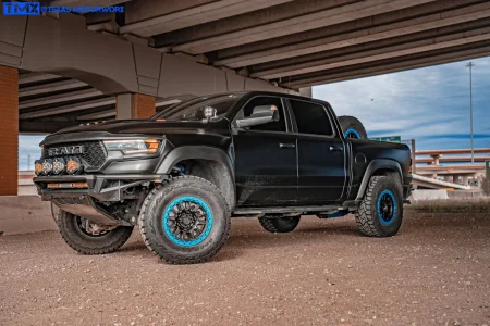

Any issues installing the parking sensors into the new front bumper? I've watched a couple other install videos and that always seems to be a little bit janky as far as how some of them mount.
It’s a fight to get them back in for sure. The plate steel is just too thick for the plastic retainer ring from the factory bumper. A little patience (I don’t have much so I had the wife do them) and you can get them in there
Is it possible to shave the bumper from the back to assist fitment?
You could probably hit it with a flap disc on a 90 degree angle grinder and thin it out a little. It’s take ya just as long or longer than the patience concept lol! Once you get them snapped they seem fairly well stuck
