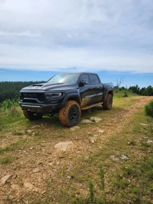

I am looking for an alternate tow hook for the front as wellView attachment 105055
The tow hooks look really bad. Why didn't the add Clevis mounts? I didn't like the SF in pictures but I needed a winch so I wrnt with it. I love the looks on my truck in person and no tow hooks.
just keep 1-2 D-rings on board and you're good to go. I added 2 d-rings to my front bumper & fabbed up some 1/4" thick neoprene washers so they're snug as a bug and dont rattle around
Yea those clevis mounts look WAY better. This is one of the few ADD’s I’ve ever installed that didn’t have their hook design on it. And I really wish they would have
