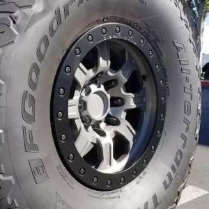

I just picked up my INNOV8 Racing G500’s yesterday From Jason.
I went with the 18”X9”, 0 offset,5” backspace in hard anodized with the rock R rings.
I am concerned that the 37x13.5 tires will rub as they are 1.10” wider then the stock rim and tire.

Don’t think it’ll be a problem with the kings
What offset did you go with on the wheels?
The kings wont change the fact that the tires and wheels are wider then the wheel wells.
What are you concerned with them rubbing? At full stuff?
I did the 0 offsets as well
Yes,that is my concern.
I have not bought tires yet and am leaning towards the BFG KO2 as they are approx. 14lb lighter than the Nitto Ridge Grappler.
On the calculator they are approx. 1.10” wider than stock.

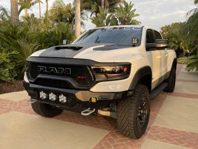

One more item checked off the list….think the tow hooks may have to go.View attachment 104995
lol, yeah, those tow hooks look wonky...
Isn't there some vertical hooks, that could be placed in the stock location?
Looking forward to some pics, with the wheels on.... Looking for a new front bumper, but all the aftermarket ones I've seen, leave an unpleasing void on the corners, which is fine/acceptable for this type of use... Not so much for a pavement dweller.
