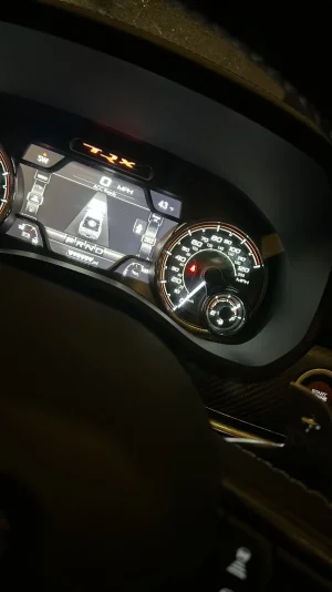

You saved my alot of stress with the help Jimmy thank you! This was my first AlfaOBD use, I'm assuming most of the setting will be in the car configuration tab. All done, just took it for a road test and works! I got those warning lights but went away after two sleep cycles.

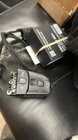

I have a similar question concerning the ACC switch part number 68309592AD. Whenever I search for it at the Moar e-store, it claims that its not compatible with the 2023. Maybe chrysler needs to simply update their database, but can’t be too sure and I was wondering if anyone had luck installing and getting it functioning in a 2023.

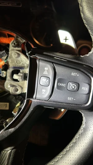

I installed the ACC switch, everything physically fits and connects just like it did on my 22. Just waiting for Alfa to release an update with the DT MY2023 PowerNet. Hopefully everything will work as it did on the previous model years.

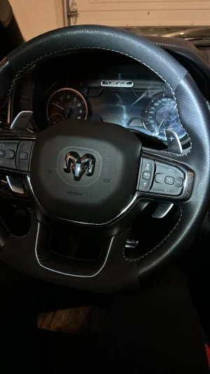

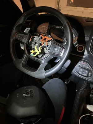

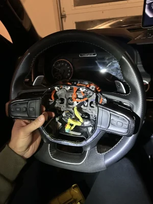

I bought my ram 2 months ago. I thought it was a pretty good deal. They had a bl;use and a black. Both priced the same, both a level 2. Black had 2k more miles. 6k total. I chose black because the color. I knew it didnt have adaptive cruise control and figured I wouldnt need it. Well after a few weeks I was pissed it didnt get the blue. I kept telling myself “I could have just wrapped it!” (for thousand of dollars fo course). Then I found this thread thanks to the RAM TRX facebook page. Less than $300 and about 2 hours total max time I got this done. I never thought id touch airbags or anything like that. I am technically inclined and I am in the automotive indusrty. But my philosophy is always “pay the pros, do it right!” But I couldn’t find anyone to take on the job!
Thank you! Got it all done right the first time and it was way faster and smoother than I thought. I did unplug battery cables to be extra safe, but I didn’t lose any preset settings.
