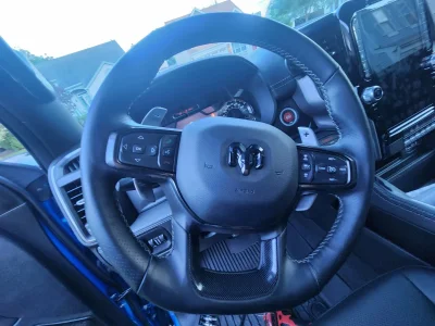

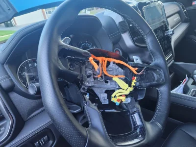

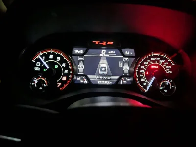

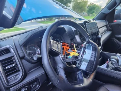

Just finished installing the adaptive cruise control. I only removed the fuse for the horn and never touched the ignition while working with the airbag. I did have to program it twice as I got collision assist service warning after first disabling cruise , them enabling ACC with stop and go. I think it just needs extra time for the remaining systems to acknowledge the change. Went back to original settings, no warnings. Programmed the ACC again, got the warnings to service the system. Went back to the house to investigate the issue, after 20 minutes went back to the truck and ACC is working perfectly with no warning lights.
Looks great! I did the same and also added lane keep assist (replaced 12” screen with the lka button) and also add peb.
