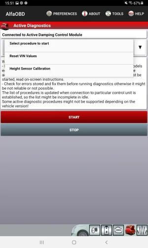

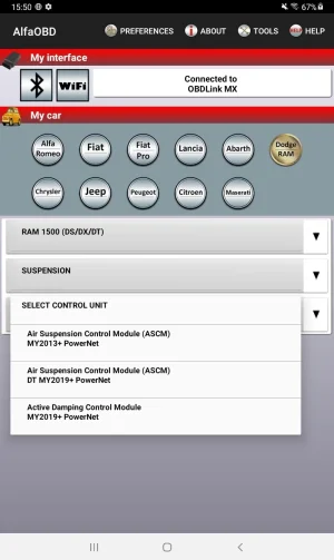

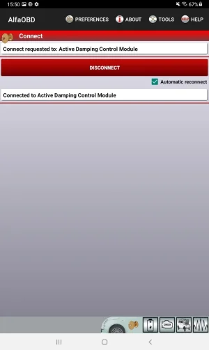

Does anyone know where the suspension recalibration is located? After putting my unlocked ECU in, I got the service active dampening and off-road limited management message. I thought it went away with a battery reset, but it returned.
Hptuners responded, they said sometimes with the TRX you'll need to re-initialize the controllers and everything will be fine. He said it's done with a Witch so I wonder if alfaobd has the same option. Time to buy it and find out I guess

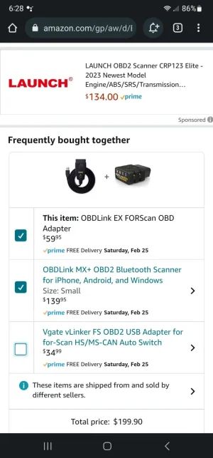

What is needed to use the AlphaOBD? An Android device, Vlinker MC and the app? What is the OBD cable mentioned in 1st post? Does the Vlinker have to remain plugged in? I’m ready to order so I can get this suspension warning off
I'll have the adapter tomorrow to see if it works. I'm guessing you have an unlocked ecu also. I bought this one but they also have a Bluetooth version. Android or PC once you download the program you can pay for the software.

Did you try the abs initialization process? I have a suspicion there is a correlation there but i can’t confirm.
I went through and reset every controller listed - didn't work
Ran the active suspension calibration on the ground - didn't work
Ran the active suspension calibration off the ground - didn't work
Ran abs initialization process - didn't work
I went into every controller listed and cleared the faults - didn't work
