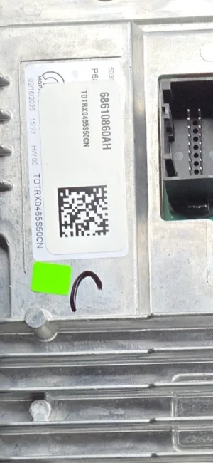

So this is his cluster
25 part number ?
I can't tell you if it is or not, but my curiosity says would it even display anything if it was a 2025 cluster?
It will load splash screens as receives switched power so it will fire up default flash but there will be no actual values been recognized as can messages are completely different so the stuff coming from bcm won’t be mapped to the new expected Atlantis can messages
I think he has the first one being delivered today. He could check to see if the part #'s match and could even install the first one and see if he has the same issue.
yeah... so thanks to Skuppy and his reaching out to me directly.. I installed everything correctly but I did indeed purchase a 2025, which wont work, I got it on ebay for a steal and I didn't realize there is/was a difference. I already reached out and returned it and actually already got a refund.. so the search continues for 23-24 cluster so I can send to UnitedRadio.. .good news is, wiring is already done and setting are already changed... should be plug and play.. thanks again @skuppy069
