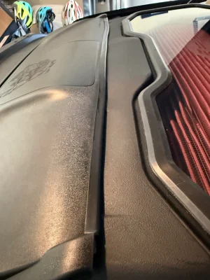

Installed the S&B intake cold air intake today and modified the stock cover to keep using the Easter egg Trex.
I saw a post here where someone used an angle grinder with a cutoff wheel, so I gave that a try and trimmed it flush. Finished it off with a U-channel rubber insert to clean up the edges and give it a more flush look .

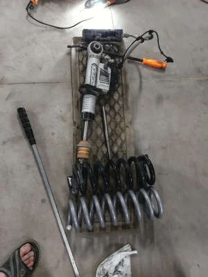

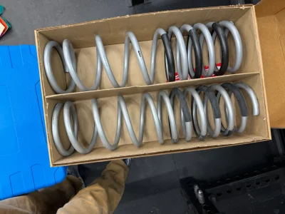

I got an ARE topper put on last week and the rear end started sagging some. I already had Eibach springs front and rear (1.6”/1.5”). So I installed the Eibach HD Springs in the rear. It definitely lifted up the rear end and the ride feels more stable. I have a bedslide and some gear that I need to load back in there so it should sit nicely.
I just put the springs in the morning and it took about 45 minutes to get it all done.

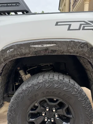

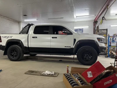

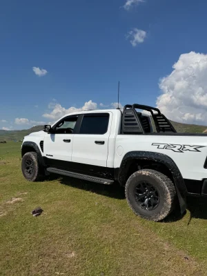

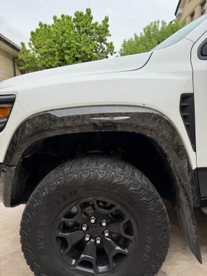

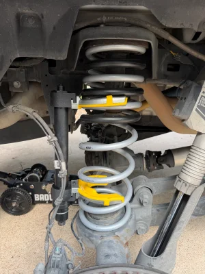

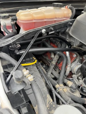

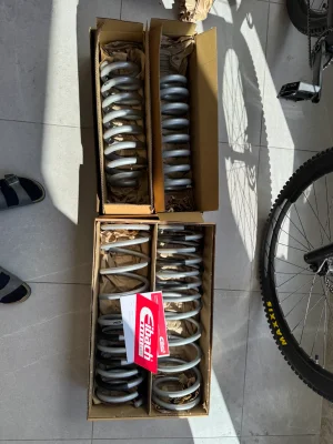

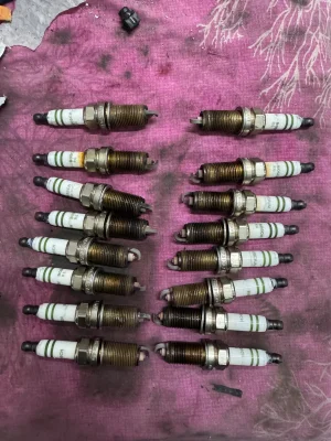

Installed Eibach springs (front 1.6, rear 1.5). Also added a J&L 3.0 oil separator catch can. Replaced spark plugs (Mopar OEM) — the last cylinder on the driver’s side was tricky. Changed the brake fluid (DOT 3, 4318080AD) and lubricated the driveshaft with Schaeffer 02382-029S
Just picked up the car from the service, and the difference is noticeable — it feels much more stable, the bouncing is gone, and handling has improved, especially in sharp turns. Planning to calibrate the height sensors in the next few days.
Mileage: ~34,800 miles
