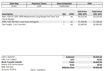

The tank, bags and freight was $5825AUD so converted was under 4k USD.
I had to get a customs broker to organize the paperwork for the tanks release upon arrival in the USA USD$260
Then I had to pay a 'warehouse' fee when I went to pick it up which was another $USD277
I went with Airlift for the compressor USD799.95.
Eibach Pro front Kit USD$399
Eibach Pro rear Kit USD$399
Labor was 16hours
I did the hellwig myself. I originally had it on u-bolts but they are not compatible with the airbags. They mount to the same area, so I bought billet sway bar bracket bushings and drilled them in. I made some aluminium plates as standoffs to create a little more distance between the sway bar and the airbags.
I think that covers everything

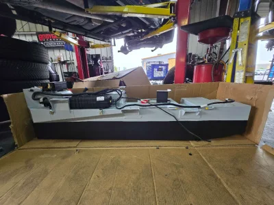

No worries. If you need any tips on the install let me know. Also if you have an aftermarket exhaust, the tank and airbags likely won't fit. The tank and airbags will clear stock exhaust though. I can't speak to other brands of aftermarket exhausts, but I have a GT Haus and it doesn't follow the stock exhaust path, most likely to improve air flow. I assume other brands might do the same. So I had to have my exhaust modified, as it was making contact with the tank at the first bend after the cats. And the drivers side airbag was blocking the path of the right side exhaust. So I had to have the exhaust cut and rewelded to clear these points. That was the biggest headache of the whole install

One more thing! Lol the tank is a whiteish color. So i had the bottom half linex'd so its less obnoxious from underneath
