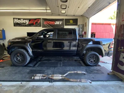

Thanks for the reply. I appreciate it. I am only considering doing it once or twice. The place for my coil packs was gonna dyno it in 4wd and give us before and after power numbers if any but he is now telling me the ram is too big for his dyno so if it won’t hurt it i’m gonna send it and do it that way.
I do not recommend using force RWD on a dyno. With the truck stationary, the front wheels are not spinning and the fwd clutches in the tcase are not getting lubed which is believed to be the reason for failures.
Drop the front driveline. It literally takes 5 minutes to do.
