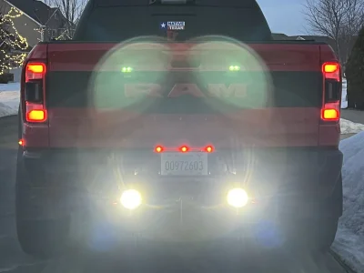

Gonna wire these up to work both in reverse, and manually via one of the AUX switches. Should be possible with a diode on the reverse wire to prevent back feeding the factory lights. Haven’t messed with this kind of stuff in a long time but I’ll finger it out…
