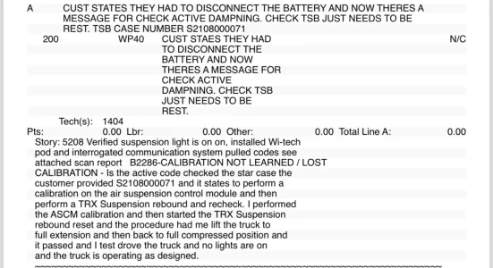

Update: Took my 22’ into the dealer with tsb paperwork and they did a reset and calibration on the control module. No lights since!
Do you have the TSB number or a picture of the service receipt that I can show my dealer?
Sure, here ya go:

appreciate the response. I’m headed back to the shop and they are going to try and fix it. If that doesn’t work I’ll head to the dealer and have them recalibrate.
Any updates on how this was fixed. Just got my ECU back from HPT with the same message. Does AlphaOBD have the capability to fix this?
