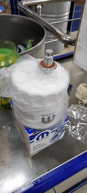

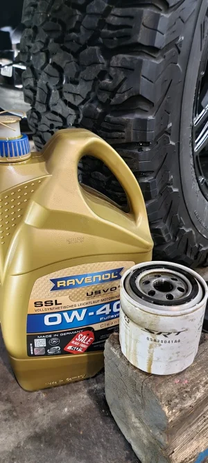

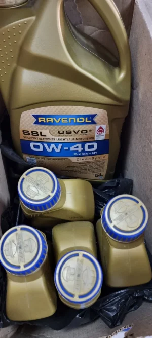

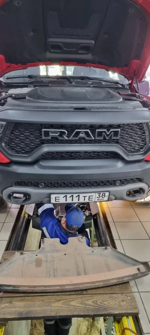

I will share my experience.
On the first TRX of 2021, I drove 45,000 thousand kilometers.
Now I have a 2022 TRX on it I have 55,000 thousand kilometers.
I have been filling oil since the purchase of Ravenol 0W40 SSL oil filter Mopar SRT MO-041 05038041AA
