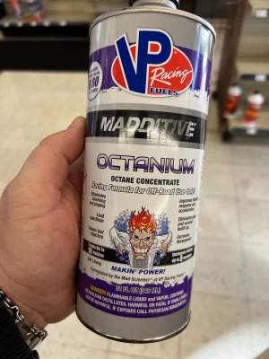

Hey Im in Anchorage. I use VP Octanium from Napa. Its a little spendy but it has so far performed well. One can treats 10 gallons and raises octane 7 points. but almost always trying to put in 91. As you know you just cant always find it traveling in this state so i keep a few of those VP cans in the truck.
Just now at O Reillys
