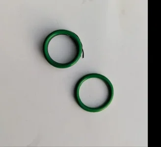

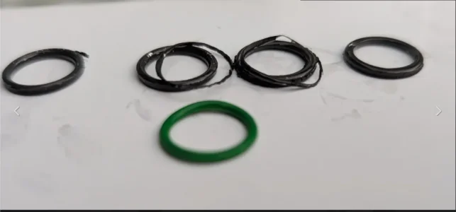

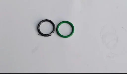

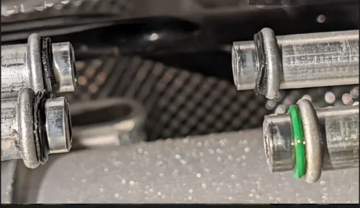

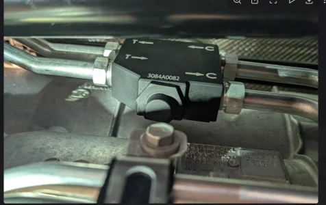

I did the bypass on the truck today went smooth o rings were bad I bought new ones and we will see if it leaks ....ill post some photos so far happy easy job I didn't take out the drive shaft can be done but tricky
defiantly need finesse not gorilla strength for this job
O and don't worry about leaking it dripped a few times thats it, half of a shot glass
I DID USE HARBER FREIGHT O RINGS SET fyi lol it worked for me
temp 167 transmission highest stop and go red lights traffic 92 degree out and 40% humidity
ill take it !
Hope this helps love having photos to see what it looks like before starting haha

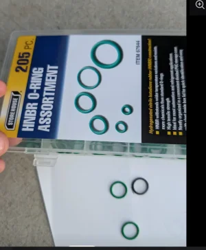

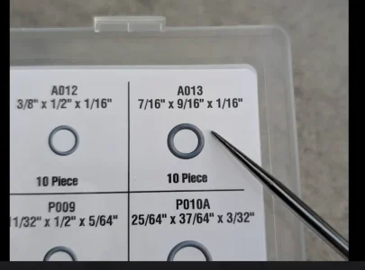

this the o-ring kit you got that worked right?
ill take it !
ill take it !
Pretty much exactly what my OEM O-Rings looked like lol.
Yup!
