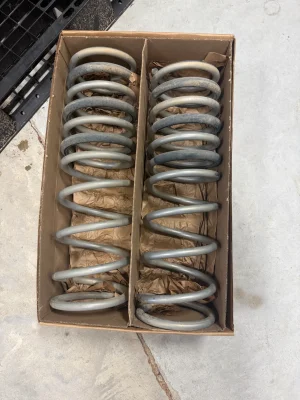

Standard eibach lift springs up for grabs now since I just swapped to HD.
These have been on the truck since March.
Make an offer if interested.

Eibach HD’s and a good bit of preload got it driving better. I’d bet it’ll handle the rough stuff quite a bit better now.

Where are these located? I might know a guy

I put the standards back in and the HD’s are up for grabs now lol. Northwest Florida
