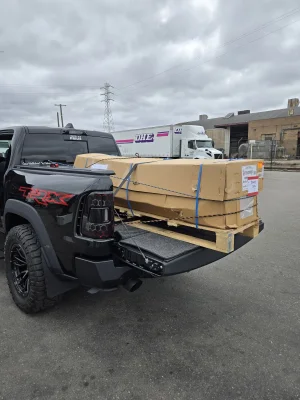

Picked up the tank today. She big. Install is scheduled for week after next.

This tank is awesome. Reminds me of the 46 gallon Transfer Flow tank I installed in my old Tundra. Loved that thing. Same concept and this one is is even bigger! Winning.
I am definitely following this add-on. How much does it weigh empty? Let us know how the calibration goes; as well as, the range and weight it adds to the truck.
I don't have anything big enough to weigh it, but SCD performance says its around 150lbs. Trying to lift it, sure feels like it. Things made of 2mm aluminised steel. Im assuming its going to lean a little bit so I'm getting bags installed with the tank to level it out when shes full. I'll see if the shop can weigh the factory tank once its removed for a weight comparison.
Does this take the factory fuel pump assembly? Wondering if the Fore unit would fit this.
This 205l tank is badass, I want one. Subscribed. @Snowbaruu would like to hear how the install and post install thoughts on this thing.

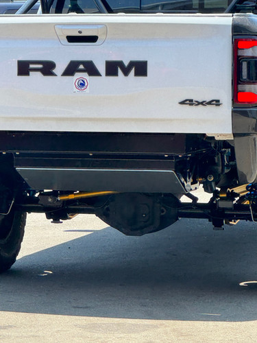

How does 32 gallons of gas behind the axle improve weight distribution?
How about 120 gallons?
Deon @Inklvr69 (IG) added this to his TRX bed for e85. Thirsty rig with Redeye, then DSR1150, then DSR1500 swaps! You may have seen this TRX on the DSR social media (at 1375whp on their dyno) and most recently sporting the beta, not production ADS shock offerings! He also has a 1/8m CTD race truck alongside Poor Boys Diesel (Phoenix) that was featured on a Hoonigans episode.
He is not only fearless having launched this TRX further than anyone I've seen, but also tenacious to source vendors/solutions aggressively...and have them made when they don't exist.
Here is a screenshot from IG I saved (sorry, banned permanently from IG for ...words re: providing the other two pics! Dirtfab Designs is located in Phoenix https://www.facebook.com/p/Dirt-Fab-Designs-100067113722055/?_rdr
