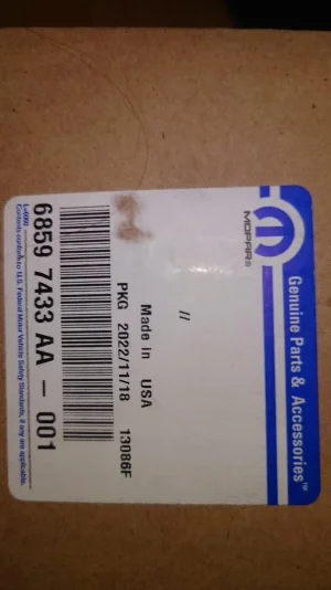

I had mine done a year ago and the clunk is back. Out of warranty now so not sure if I'm just going to buy the kit myself and install it. That way no week at the dealer for a 15 minute fix.
Kit comes with grease, boot, clamps and screws need to do it.
Part # 68597433AA
TSB 03-004-22
