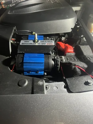

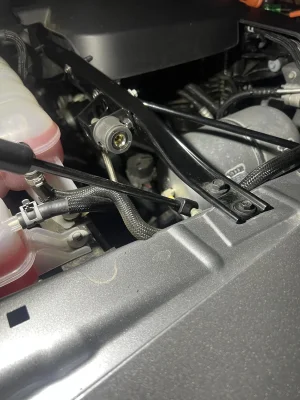

Thanks to Bill and Brawler Fab. I was able to install the dual ARB compressor kit. As some have mentioned before, the hardest part is getting the OEM battery box out. I created a whole new language by the time that fell out of the bottom of the engine bay. Quite honestly, the hardest part is ensuring you get all the Christmas trees out of the box BEFORE you unbolt it from the frame. I had other challenges but I chalk those up to my poor skills. If you are on the fence with the install, I will tell you that I did it with minimal skills and significant fear. Bill at Brawler Fab is great support!!
Pics or it didn't happen!😉
