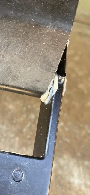

How loud are the mopar steps? I just had them installed at a dealer and they seem pretty loud with a thump at the end.
Here is a video but you can’t really tell in the video but in real life they’re very loud. Also is that much wax necessary?

That’s normal.
Well its definitely normal. I had the 19 limited for a little over 3 years and zero issues with the steps. They sounded that way from the first day until I sold it and when I installed new steps on the 23 TRX, they sound exactly the same. No experience with the AMP
Sounds normal to me. I haven't noticed much noise difference between mopar and amp. I have mopar on a 22 3500 and amp on the trx
