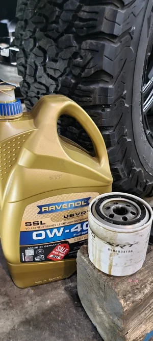

I’ll add my 5 kopecks, I change the oil every 5000 kilometers, and I put the filter on white SR it is more effective than all from the list. I used it on my Trackhawk, i SRT
