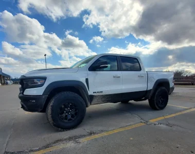

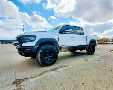

The truck doesn't rub at full lock with 37s. I haven't jumped it, and yes it might rub then. But its very usable with 37s, I ran a one inch lift on the Gen2 raptor with 37s and it wasn't nearly as usable. Cheers!

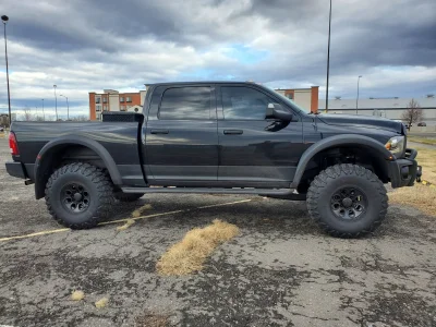

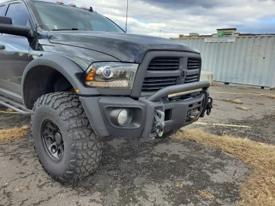

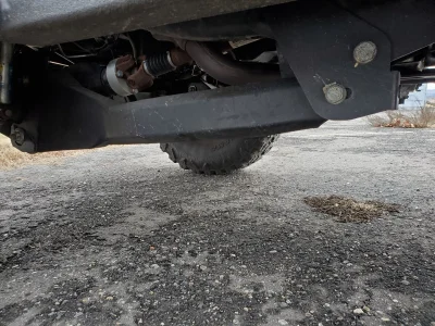

I would like to see an AEV style kit for the TRX. I did the kit on my 16 power wagon and ran 40's with no rub at full articulation. Granted the front axle was moved forward and the fenders were cut but keeping the center of gravity low made a nice clean look. I should add I also did 488 gears, EBC rotors, PSC hydralic assist, currie radius arms, and a few other things to set it up to handle 40's. The TRX jump to 37's shouldn't require anything more than a speedo adjustment.

Nice! I love AEV rigs. I almost bought a Prospector before the TRX. How’d it do for daily driving/road trips with the 40s?
Great. With the 6.4L and 488 gears i could do 80mph without issue. I wanted an 8ply tire and so went with Geolandar xmt's. There are Prospector XL's for sale near 102k new. The AEV kit was designed for the diesel application. With the power wagon I added Truxxx 1.5" spacers to have it sit close to level. The truck ended up having 1/4" rake. The AEV front bumper was several hundred lbs as well. With the diesel truck application i believe they run 410 gears.
