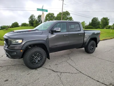

Before I do a bunch of research to try and reinvent the wheel, has anybody successfully added passive entry to the rear doors just like the front doors and tailgate have?
The handles all appear to be identical, I'm hoping you could buy (2) new front door handles and just swap them with the rears and tie the harness into the fronts somehow.
I'm sure it won't be that easy, but I'm hopeful lol
*before anybody says, "just reach for the front doors to unlock the rear" that's not the solution I'm looking for- I'm not looking to save money, I'm looking for convenience*
