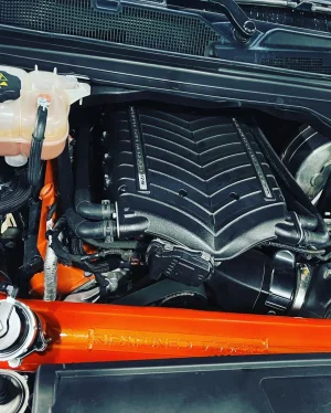

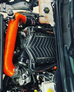

what intake are you using . do you have any pics of the engine bay?
I used a silicone elbow reducer. Since I have the Whipple stage 2 and the TTRX kit mine may be different, but I went with a 4”x5” elbow. Here is a link to their website.
Only pictures I have in my phone, but I can send better pictures when I get back to my shop in the next day or so. Hope this helps.
