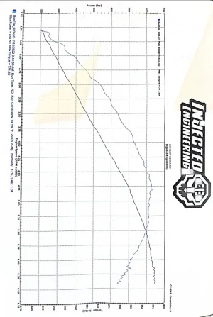

Awesome build. Do you have the dyno sheet for the base tune? I’m curious to see the curve… guessing no sign of plateau near redline. The blower VE curve for this Gen V looks great but haven’t seen any real world output yet. Keeping an eye on these builds to see just how far you guys can push the stock bottom end… explaining to the wife that I blew the motor on the truck that’s supposed to be our reliable road trip vehicle would be tough lol.
Here is a dyno sheet for my build to date. Hopefully this helps answer some questions for you.

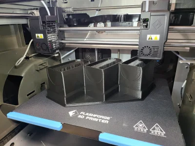

I'm making a gauge pod setup right now to install next week during the whipple install. This will be going in the upper glove box and will be hidden unless it's left open. First pic is how it will look, second pic is a rough FDM print for fitment purposes, last pic is what I'm going to make it on!
Thank you. Stock cam?
Looks like that blower still has a little left in it and pulling almost linear all the way to redline. 👍 I’m guessing since you said just base tune that it has a very mild timing curve…looks like especially up top.
Stock cam
Lots of room left as I am on stock fuel pump (no BAP), 3.75 pulley (Whipple standard) + tuning based on adjustments/changes

Stock cam
Just my opinion
You're running the Whipple 3.0 with 1200CC Injectors, 180 Stat, and making 800+ on an E85 base tune? Hot damn, with how the Whipple sounds on these trucks it makes me want to get in line.
Any idea how much power these can reliably make on regular pump gas? Assuming you'd need a BAP.

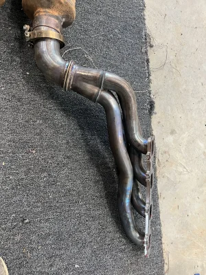

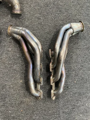

I have AR headers now and will be replacing them with shorty headers for the turbos to fit where they go. If you know anyone looking for headers I will be selling these. I have about 4-5k miles on them. Cheaper than new and no wait, I have them in stock, lol
Are they full length headers or short?
Some call the ARH full length, but they are actually a mid length with a flange to a collector elbow. Both pieces together are close to a full length. I have someone committed to buying them now. I will let you know if he doesn’t, but I think it’s a done deal.
