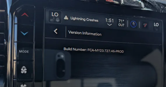

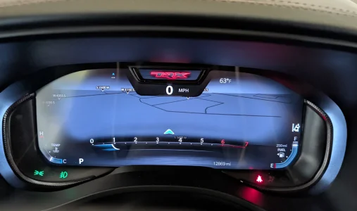

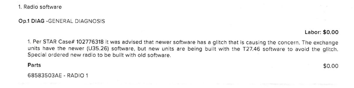

2024 Ram TRX navigation not loading in the digital instrument cluster. This started about two months ago and yes you can switch between themes that will force it to appear but after the truck sits for 15 minutes it goes away. This is what my dealership has done so far. 1, replaced the digital instrument cluster with no fix. 2, replaced the uconnect 5 nav radio with no fix. They opened a STAR case with nothing and now advised they need my truck for a few days and plan on having an agent sent out to assist with the issue. Will keep everyone updated on what they fine.
Update to my previous post on “2024 Ram TRX navigation not loading in the digital instrument cluster”. Hope this help you all in getting this issue fixed. My dealership received the new radio in with the previous software of T27.46 and replaced it. This has fixed the issue of the navigation not loading in the digital instrument cluster. The glitch was in the U35.25 software. I have attached the notes from my dealership along with the STAR Case# and screen shot of T27.46 software.

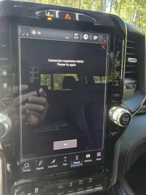

So after this weekend I'm pretty much convinced that some of the issues I'm having have to do with Android Auto. I started getting the frozen screen followed by loud buzzing then black screen reset like others. What I did notice it seemed to happen every 3rd or 4th start up and about the time AA was connecting.
Then that seemed to magically stop for the most part, but I would get the below message like every 20 to 30 seconds and AA would not connect. I restarted my phone and AA connected with no message.
So over the weekend I decided to remove the phone from the truck and delete AA, reinstall with updates and start the connection from scratch like the 1st time (wired to truck). Well now AA connects wirelessly, unfortunately now I have ad box at the top of the screen again...lol. Fortunately I did not get any ad pop ups, just the box at the top of the screen, there has to be a connection here somewhere!
