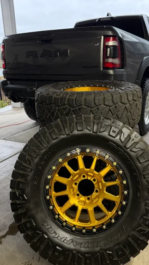

New wheels and tires arrived on their pallet.

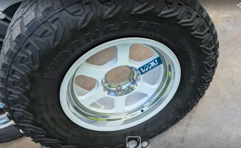

curious how the balance beads work out. I've been told by a few to stay far away from them but they still intrigue me. Do you offroad yours?
so I always run there on my trucks never had a issue ....but I do not off road
most places hate them because there a messy and fall all over there tire machine .....I had a problem when my shop did them too they use to small of beads (counter act) brand and they get stuck in my valve stem core lose air and can't reinstall tires. ....so I bought a tire machine Chinese one 1300 bucks dismounted the tire new TPMS sensor a bucket of balance beads(Martin's industries magnum plus ) for 180 bucks 18lbs haha there are large in size I tested with the valve stem they will not fit the smaller 2 holes on the tpms valve stems ,but on other valve stems with no sensor they fit .... I always go by weight not tire size..... so tire plus rim on a scale im at 82.4 for me 6.33 oz I add 6.5 oz we will see how they feel ... I have not tested them yet trying to relocate my catch can before I go out test drive new intake in stall as well Cornerstone to jmb once I like it I will sent it out to powder coat blue
a lot of work but worth for me love the clean rim look .

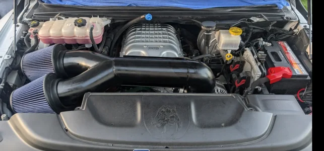

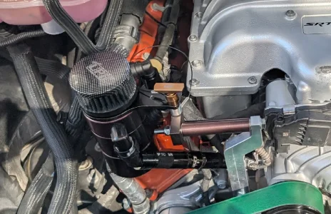

so I got the jmb intake on, what a pain had to relocate my upr catch can...
I swear all these intake there shitty rubber Grommets I can't wait to build an intake and sell it for 2k tig welded and stainless steel weld in bungs.....or just one for myself... haha I didn't even Wipe the finger prints off don't care haha once test drive is complete and new filters ordered afe I will send it off to powder coat blue

If you want to touch up the paint rub on the blower lid, this stuff is honest to god a perfect match. Mine had similar marks on it from the intake and can’t even tell anymore.

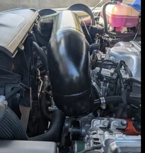

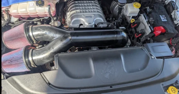

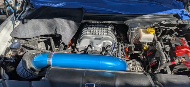

so long story short I bought a welder ....this what I want to build I was gonna buy it the guy got fired etc... but I have photos ..... I had a k&n intake didn't like it ,sold my cornerstone with was nice ...now I have a jmb its pretty nice the 5 inch tube gives me low end torque don't starve for air .... but fitment don't like it .... this is what I want to buy / now build
I sent this photo to some shops nobody wants to do it if they do you know where the idea came from lol
I want to build a intake with weld in bungs and quick discount vacuum line for easy maintenance plus dusty environments nothing with get passed ....
here some pictures
plus trying to do the rho hood ram
I bought a bunch or parts
if anyone know how to weld or want to try to build one I got a new welder miller 220 mutimatic haha
