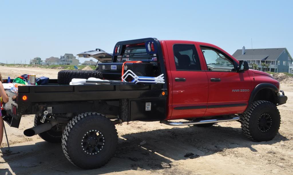

Just remove the bed. You don't need it. get trailer lights and splice them in
Hah - hadn't thought about pulling the bed. Want to meet in the middle - aluminum flatbed - TRX-F?
