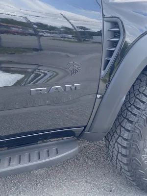

And the it still has another animal marking on it. RAM.....😂😂. 3 animal markings on one vehicle.... sounds like a confused truck.. I have the trx badges. May need them alittle smaller. Hard to fit in the contours of the truck. Even where it says ram... anyways. I had ordered these hellcat badges. Take a look

Truck looks great! :) "Sounds like a confused truck"...for sure. :) Nice job on the application of yours. :) I'm still waiting on my truck to land at my dealer from transit. Hoping maybe for next week.
