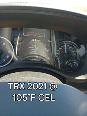

Any getting a P0128 Throttle Pressure Sensor output Rationality CODE on dash then CEL ... Then limp home mode....after new air intakes in California or other State vehicles?
P0128 - Throttle Output Pressure Sensor Rationality
CEL
CEL
Also electronic Nanny kicks in at 117 mph and Advises " Avoid Erratic Driving Limited Stability.... " then
ACC , REB etc shutoff RED Spark on right side of display
That’s P012b not P0128. There’s a TMAP sensor after the throttle body. Passenger side. The white thing at the bottom of the pic is the PCV hose connector for reference.
Maybe it got damaged or unplugged during intake install.
