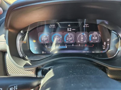

I towed an 8000 pound covered car trailer up the grade from Death Valley to Nevada a 4500 foot climb over about 13 miles, 6.5% grade. Ambient temp at Death Valley 110 degrees, top of grade 92 degrees. At top of grade highest temps: engine coolant 234 deg, engine oil 286 deg, trans oil 214 deg. Ran 5 PSI boost at 60 mph most the way. Left the trans in drive for auto gear select. Attached pic was at the top of grade, where I caught up to a slow car.
The fluid temps were well within allowed range. 286 may seem high but it was for a short period and is OK with fully synthetics. TRX has safety limits, which were beyond these temps.
I selected the TRX (2023) over the Raptor V6 or V8 (R) due to the iron block 6.2 engine. Actually, I sold my Raptor 6 months after owning and proving out my TRX. I did not want an aluminum block or small engines pulling this trailer. I have had excellent results towing and have found that the TRX has excellent cooling. The AC worked great too.
